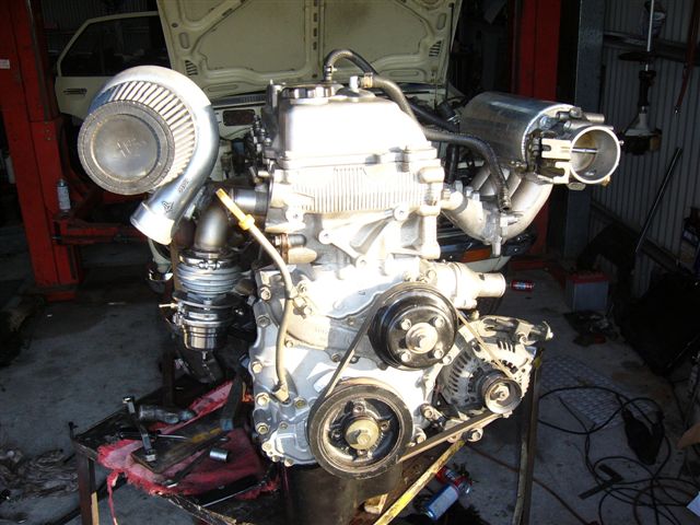

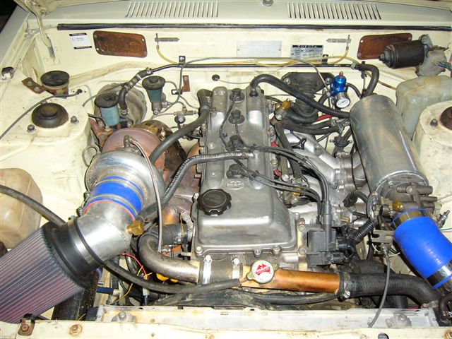

What about 1rz 2000cc 2rz 2400 or3rz 2700cc hilux motors, i,ve just finished putting a 2710cc in a ke30 & they fit like they were made to be there, got photo,s if anyones interested, much better fit than nissan
Edited by curly
the chaps in the states love the 3RZFE (that said they like the 22RE and the 3T way too much for my liking) and feed them monster amounts of boost.
some pis and a writeup'd be great.
