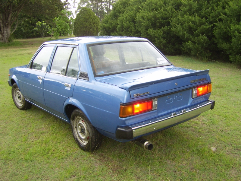

Teddy Posted September 20, 2007 Author Report Posted September 20, 2007 Windscreen when in today, was advised not to drive it untill it set ~ and it got too dark. 24 hours untill a vid, sorry ! hahaha New windscreen looks HOT. Justin finished the fuel pump & related wiring Ive bolted in the dash frame and fininshed off all the carpet cutting for stuff to bolt into (seats, belts, etc) Windscreen wiper motor missing intermentiant function ~ figguring that out still. Car is looking better each day :P Quote

Medicine_Man Posted September 22, 2007 Report Posted September 22, 2007 Last night dad put the chrome molding around the windscreen and fitted the upper radiator mounts. Well we got quite a bit done today, Dad fitted the interior light door switches, central locking door lock actuators and got the front vent panel (below the windscreen) back on. I messed about with the windscreen control relay, Resoldered all the joints inside and still had issues. Noticed the box that it plugs into was rusty inside, Cleaned the rust all away with the tiny Dremel wire wheel and then like magic it works again. (Also the blower motor works now too - Fixed 2 problems at once) I ran the wiring for the handbrake light, Wired in the interior light, Fitted the bonnet release to the dash, Connected up the brake switch, Created the reverse light harness to the gearbox and cleaned up the windscreen wipers ready for a coat of paint. Teddy has been messing around with the dash/interior getting as much in as he can and also fitted his airbox. - Video proof it moves! Quote
7shades Posted September 22, 2007 Report Posted September 22, 2007 Well... I'll be buggered. Jolly good show lads. Quote
NoPsi Posted September 23, 2007 Report Posted September 23, 2007 Nice work. Tell me there is more lowering to come though?? Quote
