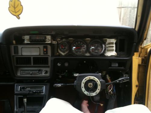

  2. Well the manual conversion is now complete! A BIG THANKS TO EVAN G FOR ALL HIS HELP ON THIS ONE! Ev did most of the work in getting the auto out, then I did all the work putting the manual in. The auto box looks to be in VERY good nick, not that I EVERhad a problem with it, I just prefer my cars to be manual. The Auto looks like it has been reco'd at some point in history, if anyone's interested in it feel free to PM me for it. For this conversion I didn't need to do any modding of the transmission tunnel as I was fitting the K50 I had lined up for my KE70, the shifter position lined up PERFECTLY. Although it's off a skew due to our dodgey welding of the crossmembers :P I've made a dodgey clutch pedal return spring which I intend to replace shortly as I don't feel it has enough tension, don't get me wrong, it works fine but I don't like how "loosey goosey" it feels. Also on start up there is a strange pinging coming for the engine, not sure what it is, but it's not a big issue. When I took it for it's first test drive it was like driving a completely different car, the feel of the manual is totally different to that of my KE70. The engine is pretty loud at the moment too, I'm assuming this is due to the trans tunnel basically being wide open? Not sure. That's all for now, this is only a temporary gearbox as well as I have a W50 Steel case Celica box coming in from QLD shortly. In a few weeks time, I will begin my Twincharge setup. Although I have altered a few plans in the setup, NOW consisting of a SC14 with 12PSI pulley kit and a T28 Turbo. Next on my list of to do's is getting the 5k rebuilt and WORKED! :D Will post pictures later. Cheers guys, Jake. PS: I've been informed to let you all know if you want some backyard work done, feel free to msg Evan G for help
  3. Love the steering wheel! Nice car!
  4. What rims you running, they look IDENTICAL to my mates old set, never asked him what they were... Looks SWEET btw! Cheers, Jake.

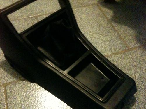

  10. So I've been a bit bored lately and been playing around and cleaning bits and pieces. On Monday I cleaned up my 2 centre consoles into 1 good 1. Although it will almost certainly require modding in the near future as I'll be running a KE70 K50 until I'm ready to fit my planned W50. Today I got bored and cleaned up the K50, not the greatest job as I only used degreaser and a sponge. Also decided to spray my turbo plenum on a whim, it is now gloss black. Also thought I'd share with you guys half of my precious boost system, the Garrett T28 Turbo! That's about it for now, plans this weekend is to complete the rest of the manual conversion, I'm gonna try and squeeze some work in prior to that. Slowly but surely the project is coming together :) It's getting exciting! Cheers, Jake.
