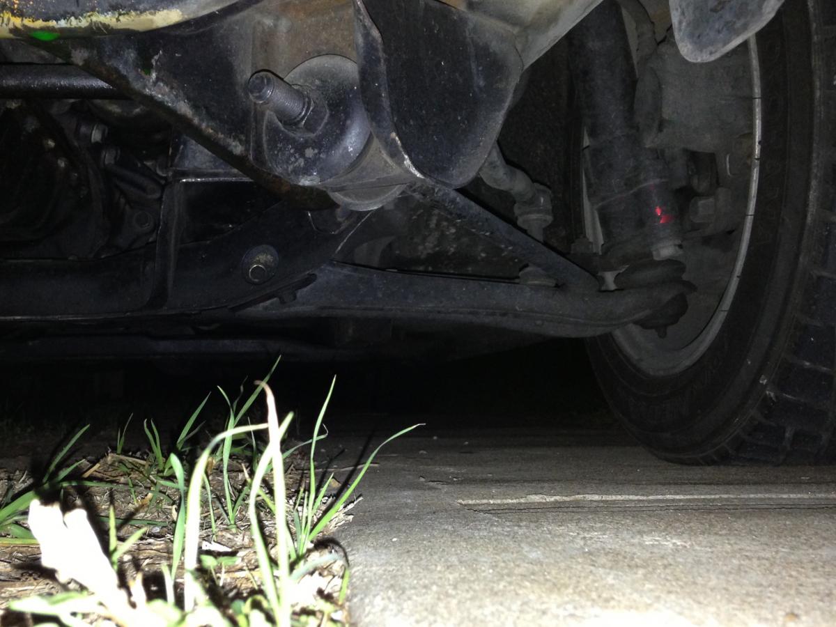

  7. Hers a pic of the angle of my control arm on my ke20 with the 33mm T3 RCA's Ride height is about 105mm at the lowest point which it the gearbox cross member. Ive always been told you want your LCA ends pointing down or flat to best avoid bump steer..
