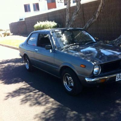

I drive a beautiful 1975 KE30 2door, running dedicated LPG on the stock motor with a 5speed K50 transmission.
