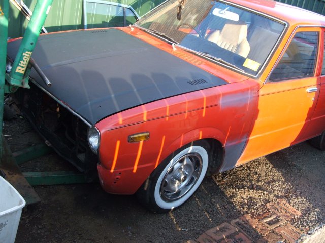

  10. Hmmmmmm my Port-A-Walls arrived today, If you don't know what they are, its a rubber inlay fitted to the rim and is held on by the bead of the tire Shame the rest of the car looks like crap.

  12. I just ordered my set of port-a-walls for my ke30 you beat me to it. But they look great.
