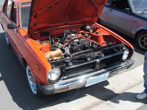

  21. Maybe we could swap some info on this conversion. I don't know when your starting, but ive now got the engine and the KE35 car, I'm just looking for a 5 speed, as mine is a manual engine and all that was missing from the VN was the gearbox. I hope to be fitting the engine within 2 weeks and ill be posting pics soon. I think the engine mounts will be the hardest part and ive done plenty of them.
