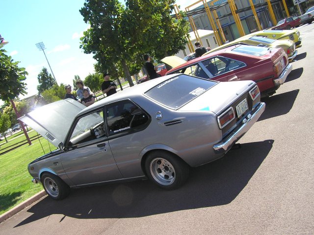

  4. Some pictures taken by Tom210 of our meet. Not as many turned up as id like to see.
