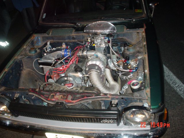

  7. mikeys toy...nah...replace your aircon with a supercharger. I must get some newer pics of it as its a little diffrent now.
