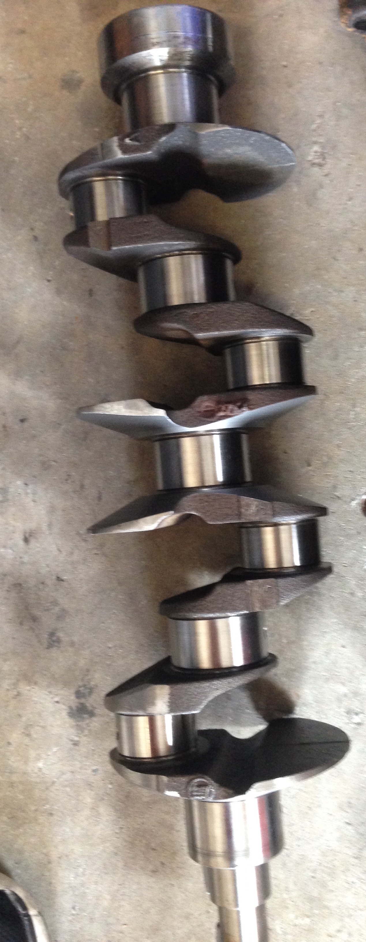

This is what my knife edged 4k crank looks like. Not sure if its the ideal thing for a regular road car though. I managed to get hold of an ACL brand kit of gumtree, as they went out of business a few years ago pistons and rings can be found here (and lots of other stuff...as ive just discovered :) ) http://www.precisionintl.com/Engine.aspx?ID=1730&EID=13086
