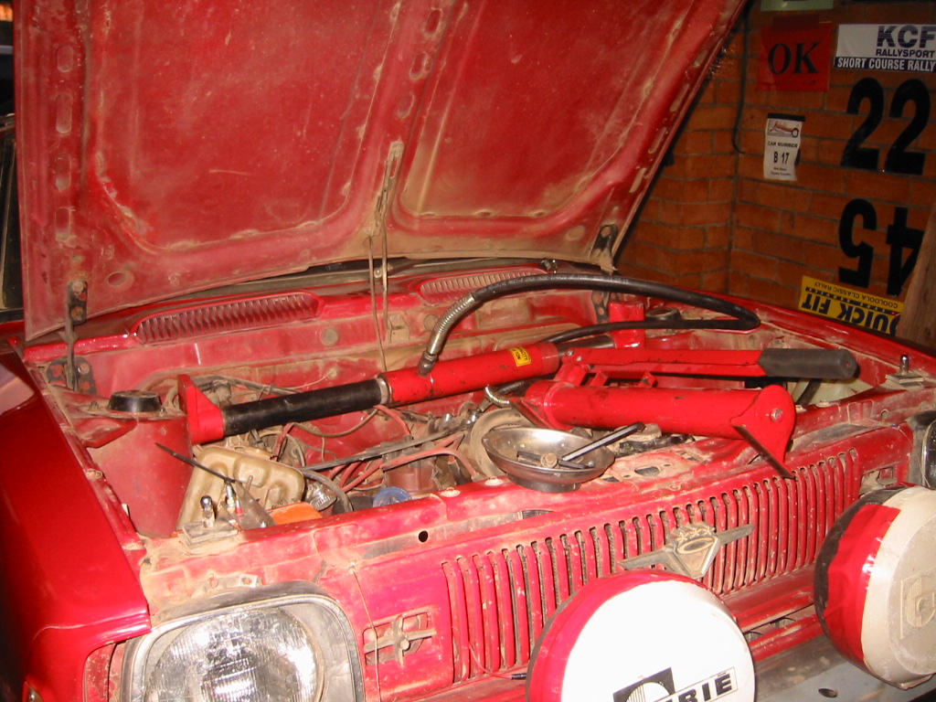

  15. Ben, not completely true. The weakest point is generally the vertical lugs that are welded to the strut plate. i.e the bit between the bar and the plate. They can and do bend before at the same time the car does. It's usually at this point that you have other problems as well. Like having to port-a-power your strut towers back again..... Therefore if you have a strong enough bar, the towers shuldn't bend. A bar with a weak point, slightly stronger towers, but not as strong as it could be. Or something. Falken. No it won't damage the car. As for what it does: http://en.wikipedia.org/wiki/Strut_bar

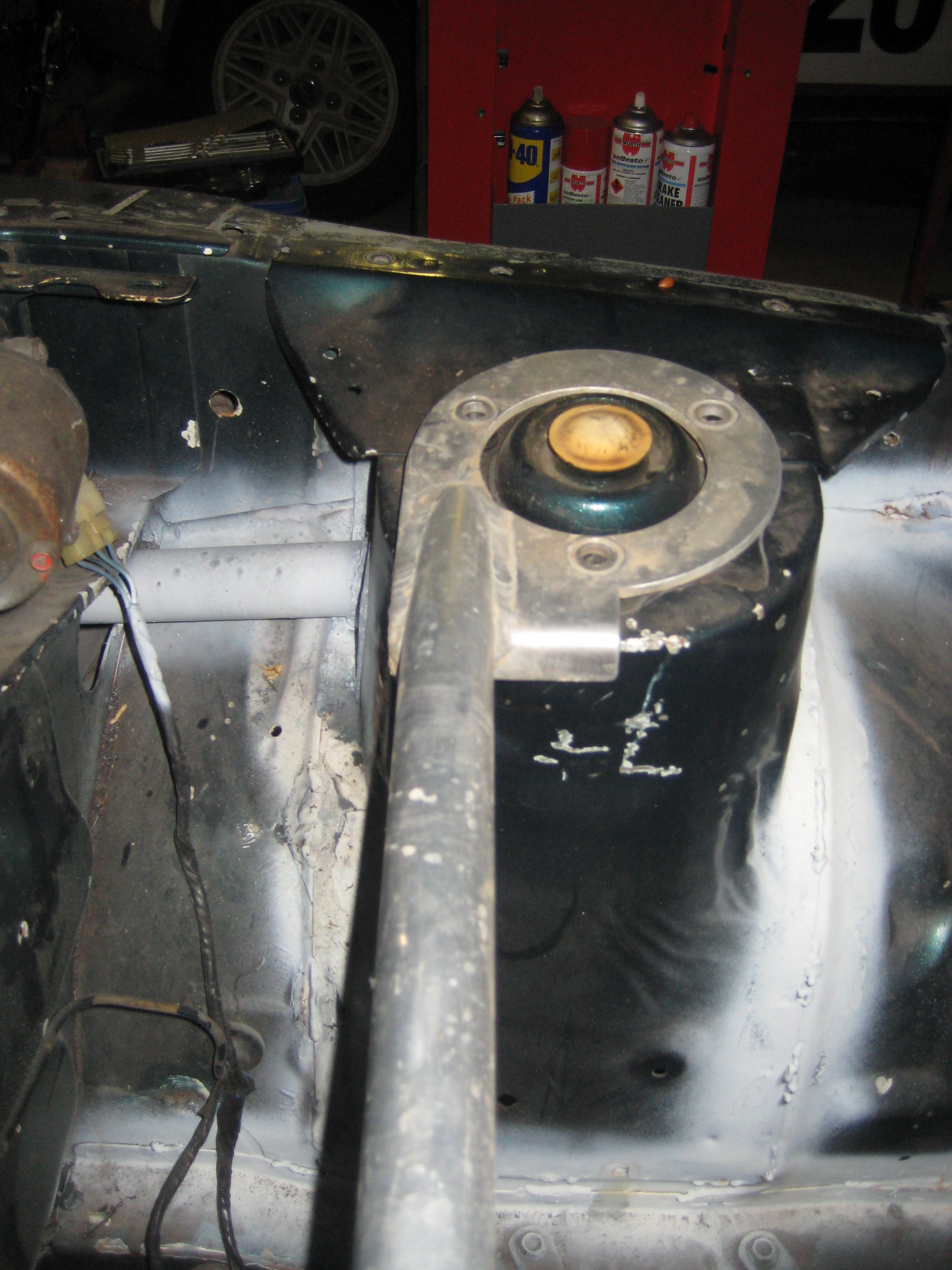

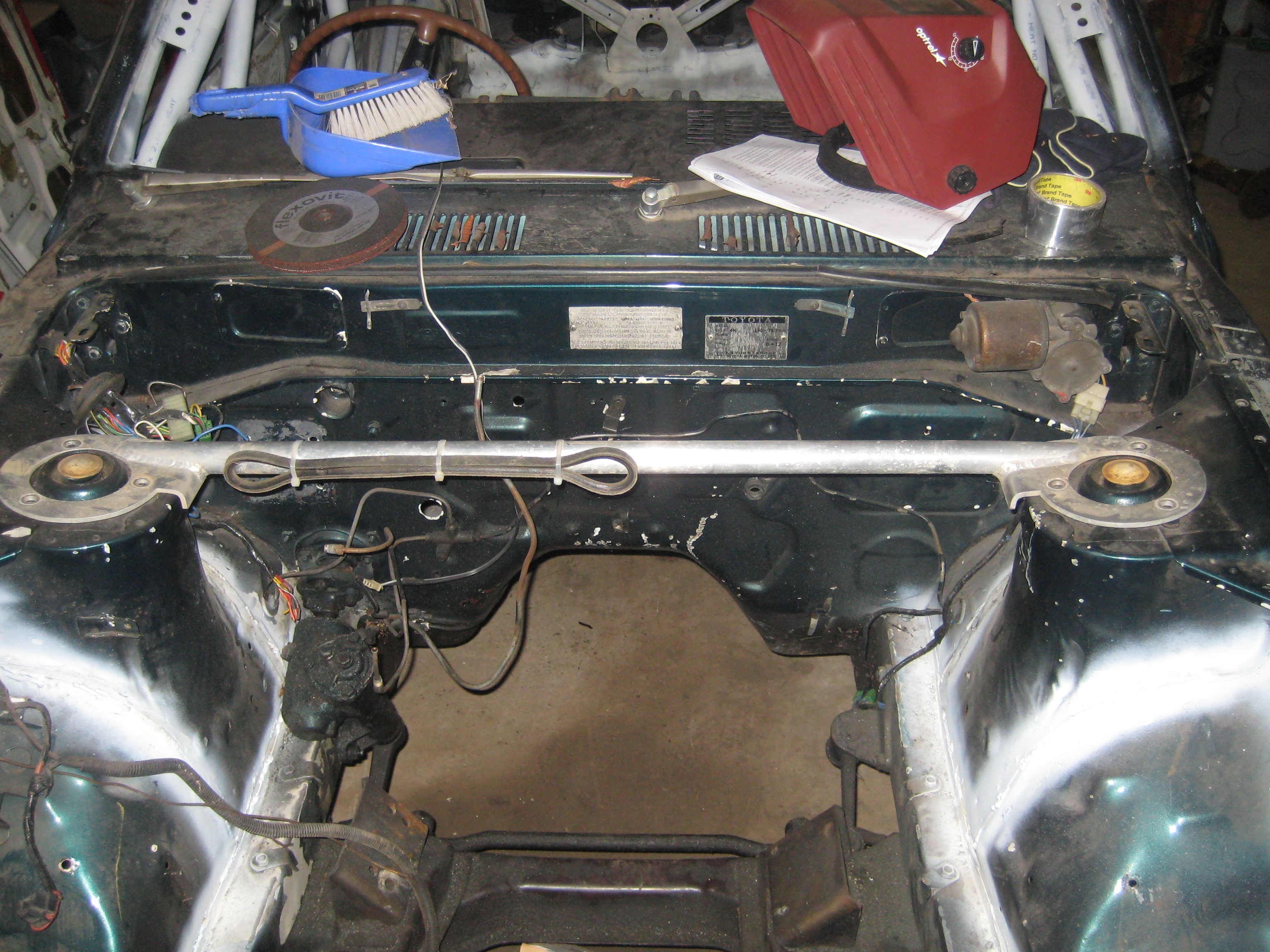

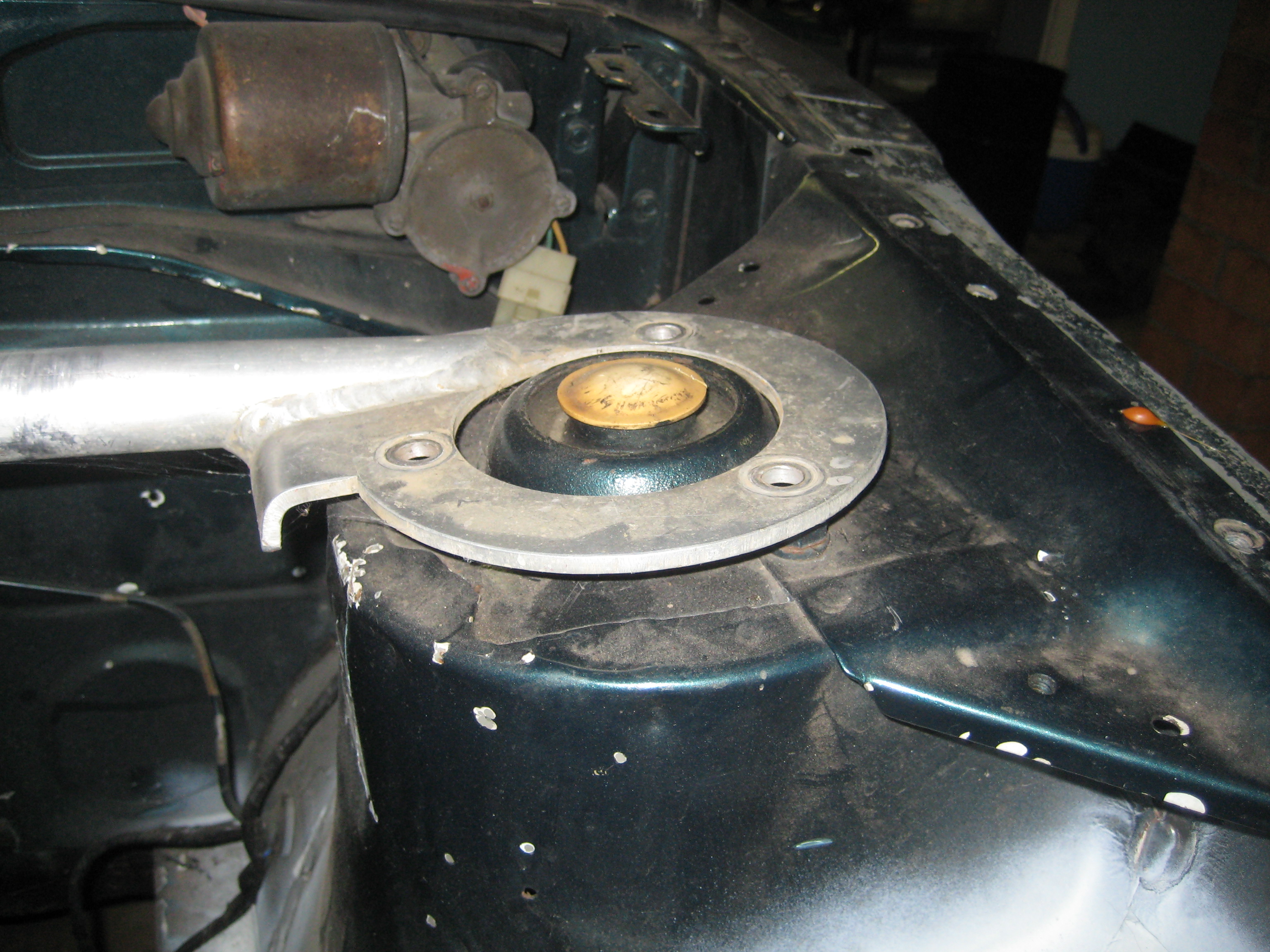

  17. Okay, with strut braces, if you're looking to compete in competition, you need to check the rule book. All of the ones that I've briefly checked state something like this: Thus one going from tower to tower is probably the best option. Most common braces are two flat plates, a raised bracket with an adjustable bar. A common fault with most mass-manufactured bars is that the plates and bracket bend, as they are not strong enough. Most people this isn't a problem, as most people have them for wank value. I personally have bent a few. I don't have a photo of the bent brackets, but this is what I had to do after: That was n the old car. I manufactured new brackets for for that and all was ... better. With the new car a bar was manufactured for it. The base plates are 5mm alloy, and the bar is 32mm OD alloy tube of about 3.5-4mm wall thickness. Can't remember to be honest. The bar is solid, and far better than anything you'll buy off the rack. If you look at the bottom pic, additional strength to the tower is gained by running a bar from the front leg of the cage to the strut tower, which is legal.
