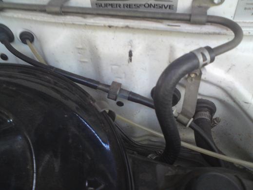

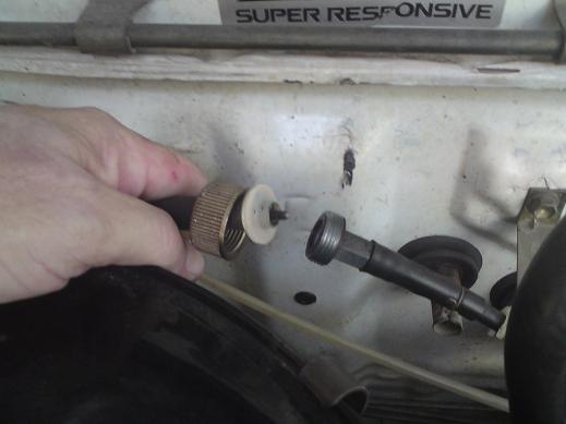

  22. There you go Trev, now you know what a 2 piece speedo cable looks like. Could be a later model thing (mines 12/87) ?. There is a bearing in this coupling that I think might be the offending part that's seized in Marti's.
  23. Not sure if the Twin Cams are different but, on my 82 the speedo cable is actually 2 piece. From the gearbox the cable travels up to the top of the firewall where there is a connection in the cable. I used to have this faint annoying squeak behind the dash (behind the clock) at low speeds, and the speedo got the shakes at certain speeds. Undid connection and packed it with grease. Squeak gone, speedo is now steady. Might be worth trying if it's 2 piece. If you do replace it, replacing the half to gearbox is a 2 minute job rather than trying to get behind the dash.
