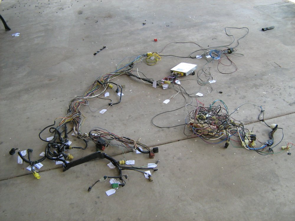

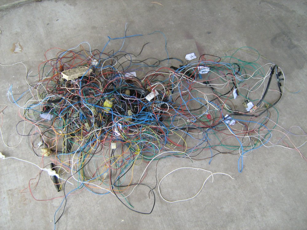

I have had some fun so far today with the GE harness and the E7 harness, Here are a few pics:

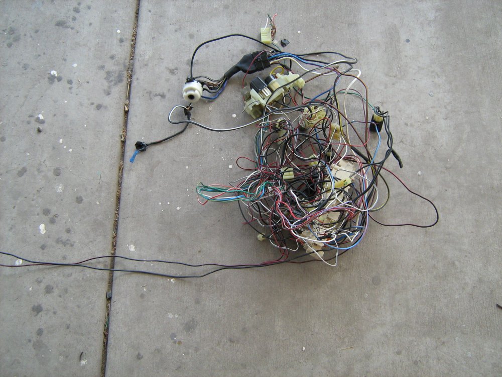

This is what i have cut off the original harness (all 3):
The 2 wires leading out to the left is all i have to sort out and the harness is done:
I have taken a little bit more out of the harness since this pic:

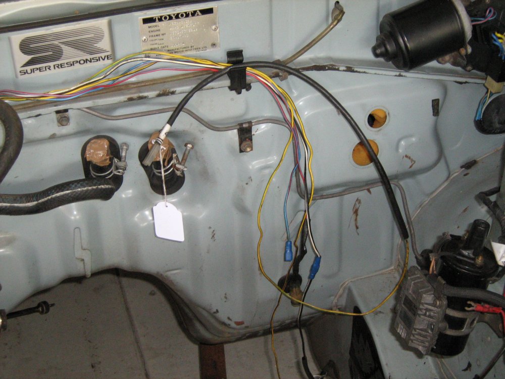

Remember the old factory wiring on the firewall with the auto plug for the neutral safety switch:
Well i took the plug off (left wire on it so if i run the auto its there) now i have a direct start signal aswell as the temp guage and oil light wires, Reverse lights and I will use the blue wire (B+ 'key on') for igniton power to the ECU which used to power reverse switch:

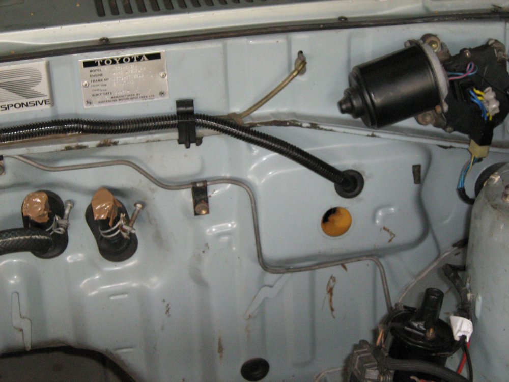

I have run it into the cabin (looks pretty) as i am going to marry all the wires upto the GE harness:
I forgot to mention that the GE harness will be fed through the larger hole under the one I just used.

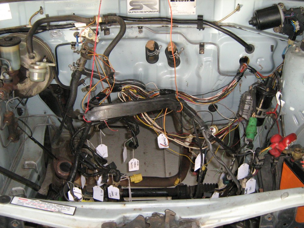

I thought id give the GE harness a test fit, Can't wait until i tidy it all up and it's in there for good.
You can run the harness through the firewall on the drivers side so its hiden more and doesnt get a chance to get heat from the exhaust.
Edited by AE70
The harness will actually sit up where the other one sits, If i put it through the drivers side it would be pointless to the setup i wanna run as i would have to extend the wires and i want it to be plug and play so its easier how it is.
