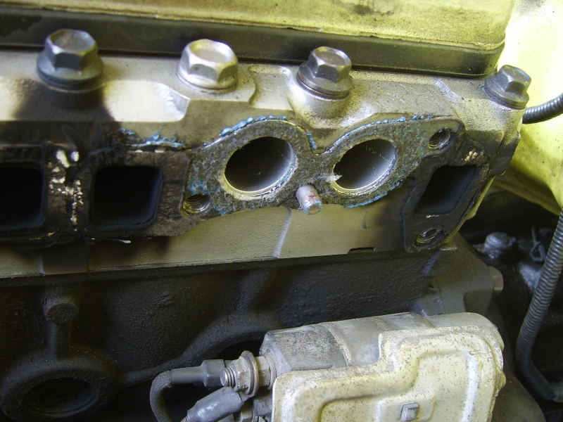

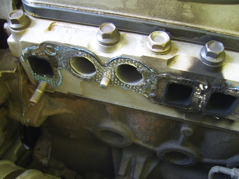

What sort of bolts are you using mate? close up pics of the manifold side of the engine if its not too much trouble

I would check your extractors/inlet for warping the problem continues
Get yourself hold of a permaseal 1 piece gasket. they're actually listed in Lukey catelogues as "extractor gaskets" and they're a shite load better than those crappy ACL 2 piece things. The worse thing about them is were the the 2 gaskets but up on the double exhaust port area (were you've got some major chaf there), and when you up your exhaust temps a hundred degree or so, they only tend to last a couple of weeks. :S the 1 piece permaseals normally last me around 6 months now! :hmm:
Plus at bursons were I buy my gaskets......ACL 2 piece - $15, permaseal 1 piece - $8. Not a real hard decision I think!! :cool:

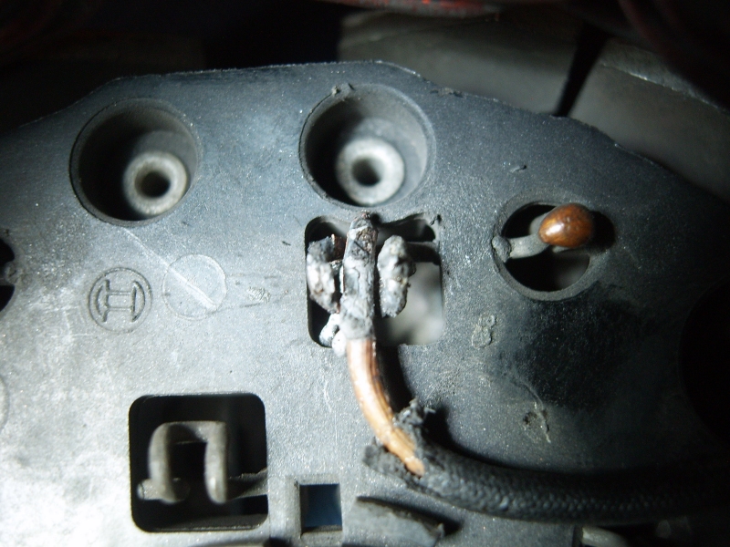

Lucky I didn't go on the cruise on the weekend, Found out on the weekend that my alternator had shit itself again (When trying to jump start my sprinter). Turns out it was a dry solder joint on one of the stator leads. Ended up upgrading it yet again from 55A > 80A while I had it apart..
