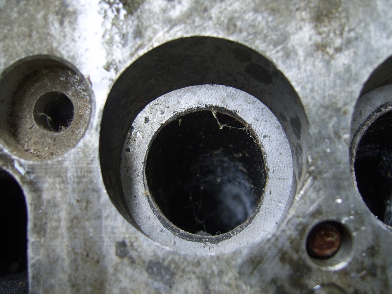

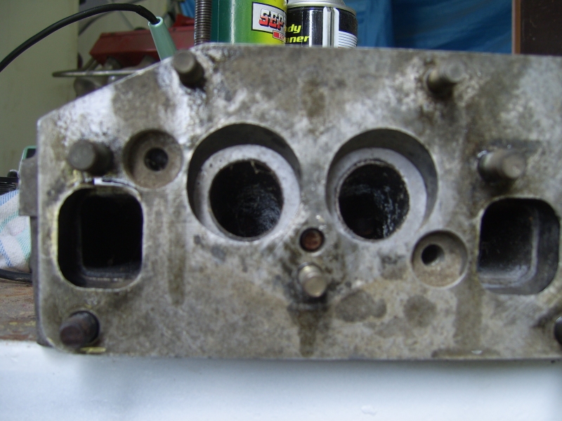

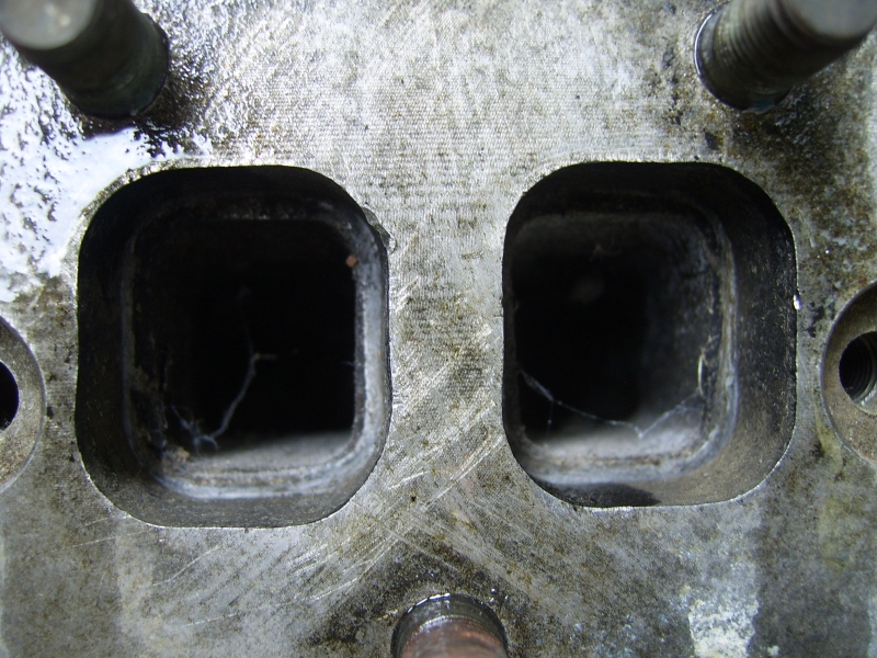

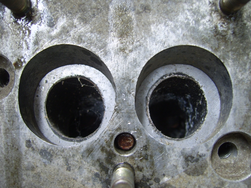

Put the plate up against the 5K head I have here today, Shows you just how much it needs to be ported. (what you see there plus a little more..) Exhaust ports could have some more taken off too..

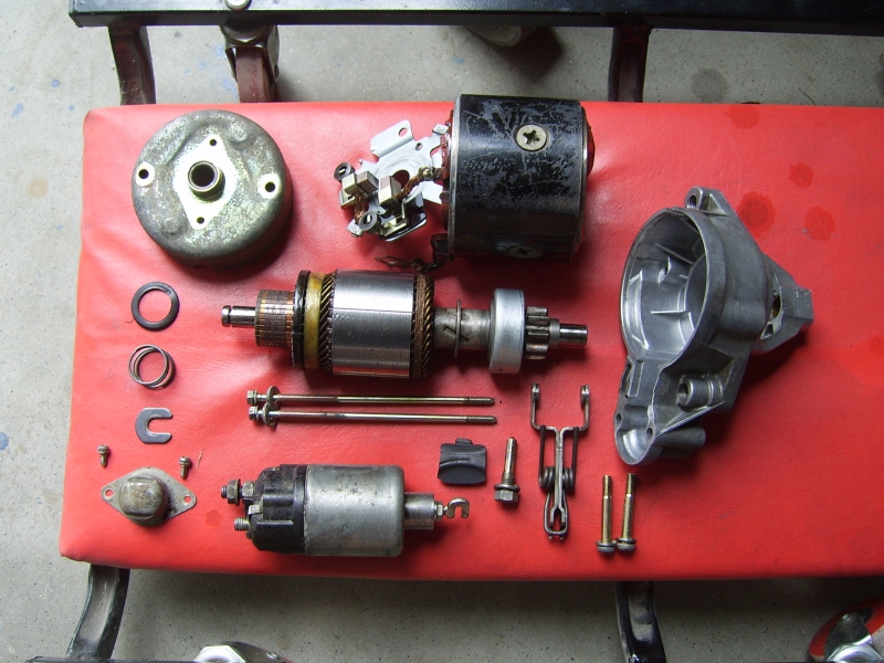

On that note, Friday night when I went to Nick's place my car didn't want to start (Lucky for the big hill he lives on).. Ripped the starter off this morning and pulled it down to reveal why I have been having issues with it lately.. Appears the ground brush has been sticking in from time to time when the armature has been poling from time to time due to the bush being flogged out. Managed to find another starter here to fix it up with today just it doesn't have the mounting stud for the heatshield (Must be an earlier one).. Managed to sort it out and got a photo of the anatomy of a K starter motor..

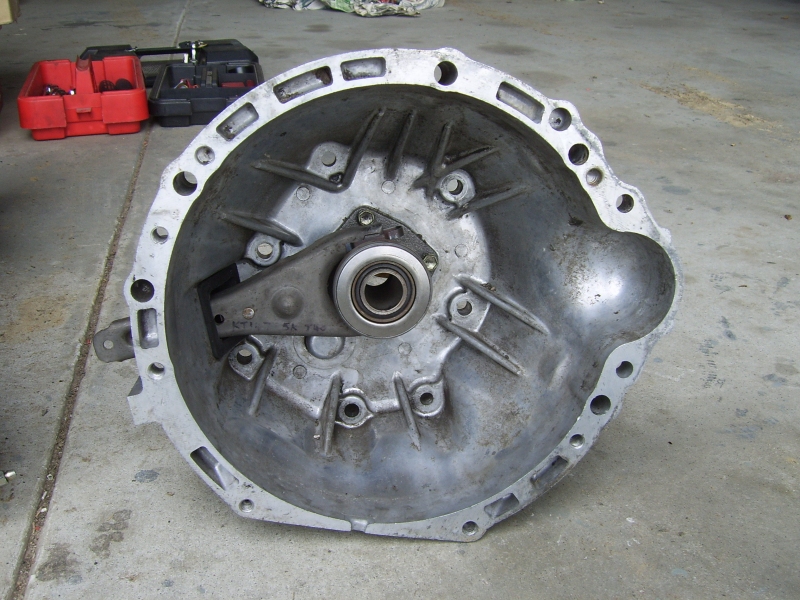

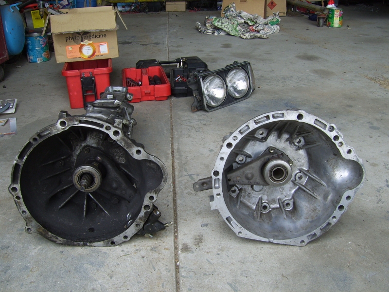

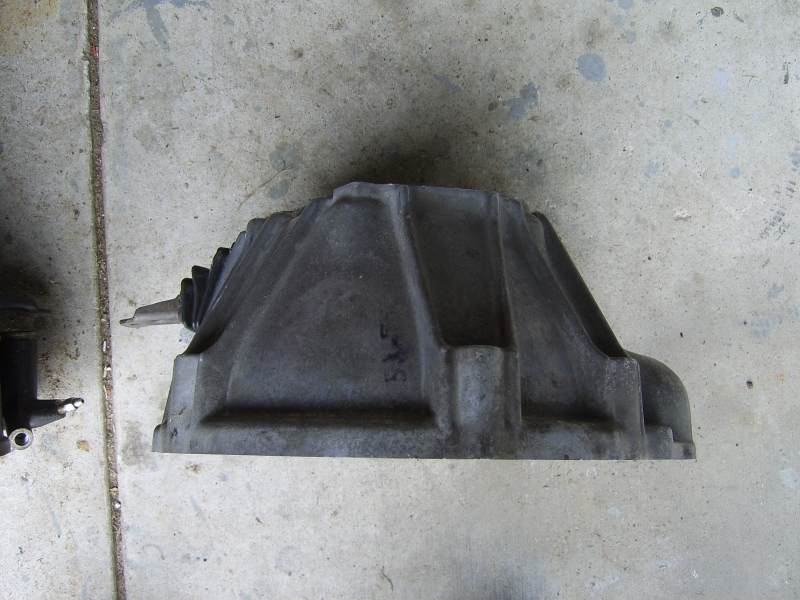

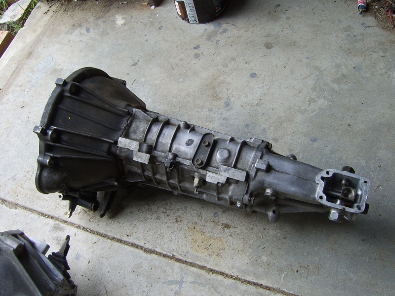

Picked up some 100kw 4AGE rods and pistons and a Aus T50 gearbox to swap my K-T Bellhousing onto..
