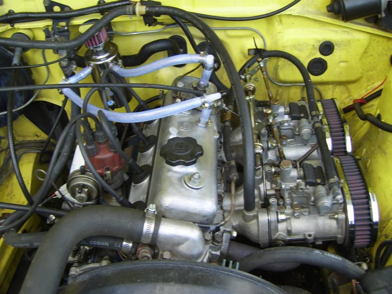

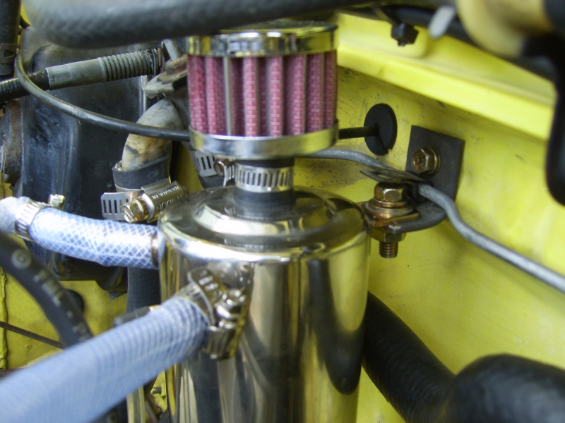

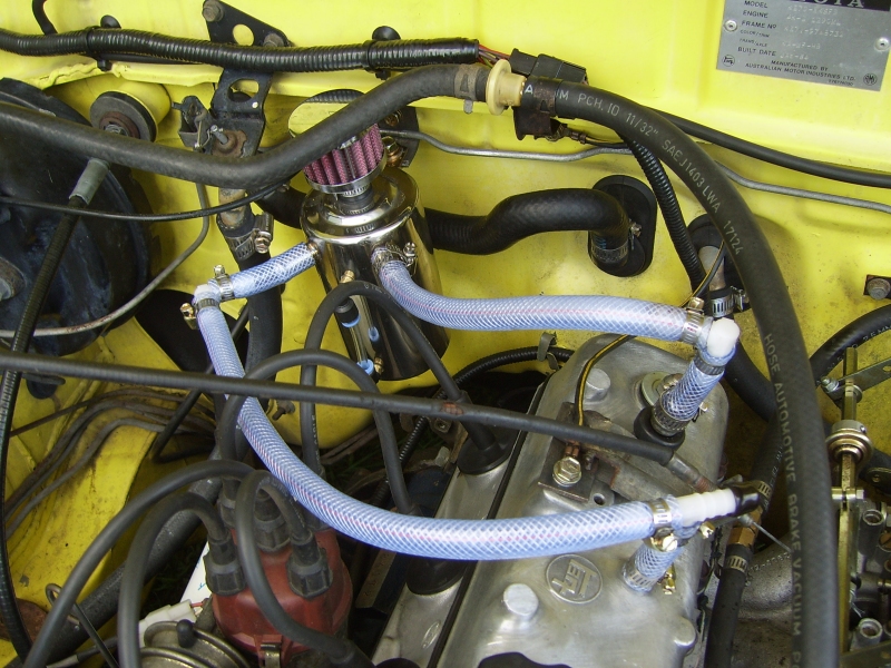

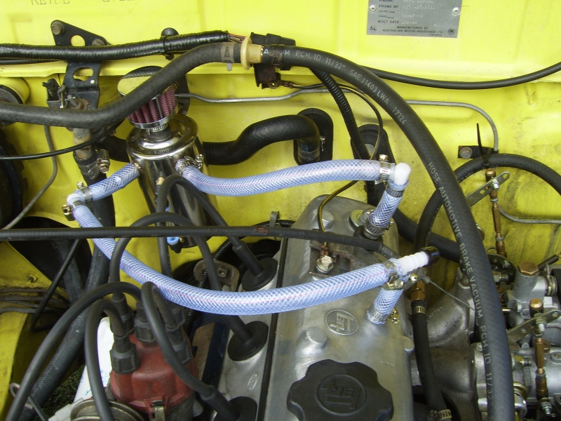

Today I fabricated a bracket to mount the catch can, Went out and got some 90 degree vacuum elbows from Supercheap (They didn't have enough in stock, Had to use a T piece and a blocker for the last one). Ran all the piping for the catch can.

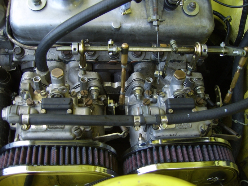

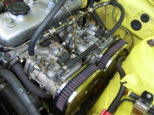

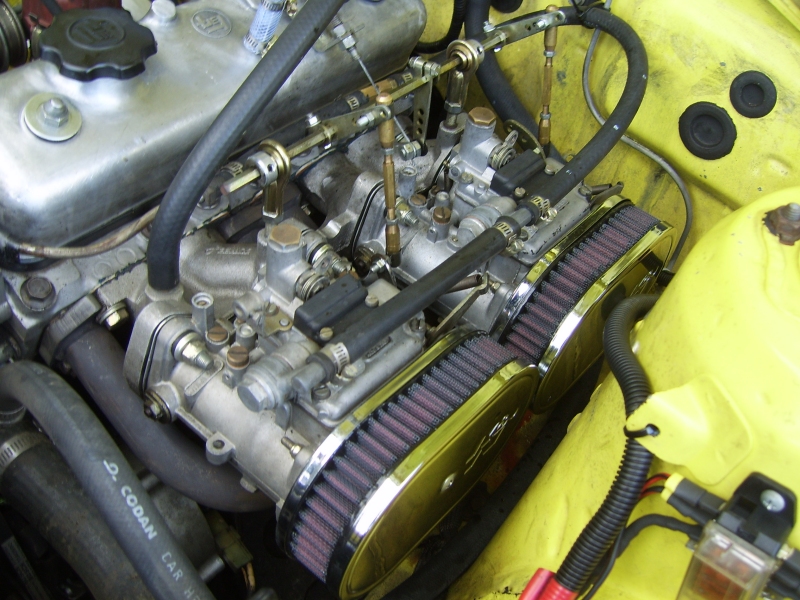

Degreased the engine bay and carbs.
Cleaned the K & N filters and re-oiled them..
Let us know when its fitted, How do you go about using the vented one as i looked at getting one a while back but understand they wouldnt be ADR approved?
Already fitted, Doubt it would be ADR approved as it is venting to atmosphere, Though this time it is not going to leave oil vapors sludging up on my firewall where my ghetto catch can was before (Softdrink can)..
Nice looking catch can that one.

I think the catch can would be the least of his worries. The dellortos would breach ADR's... But then again seeing as Justins' car looks so neat and stock, I doubt he would have many hassles from the boys in blue.

i had to vent my catch can to the CAI box where the pod filter was so the motor breaths the oil vapors in to pass engineering.
Yeah, That makes sense, Was reading some articles the other day on fitting catch cans and saw one done like that..
Makes it a bit harder with twin carbs, I don't exactly have a place to plumb it back to / no air box..
Been wanting to do this for ages so I'm glad its finally done..
Nice catch can, What material Is it made from is it polished stainless or chromed steel /brass?

Can i just ask why the dellortos would breach the ADR rules?
I know its a rides thread but id like info as i will be running twin 40mm dcoe's webbers on a 4age.
Think it has moreso to do with the fact they didn't come with twin carbs from factory and also they wouldn't be very emission friendly. I wonder though if you could get away with it if you can prove TRD made a twin carb manifold as a factory item..
