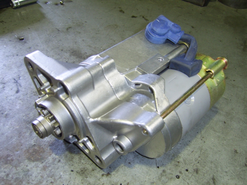

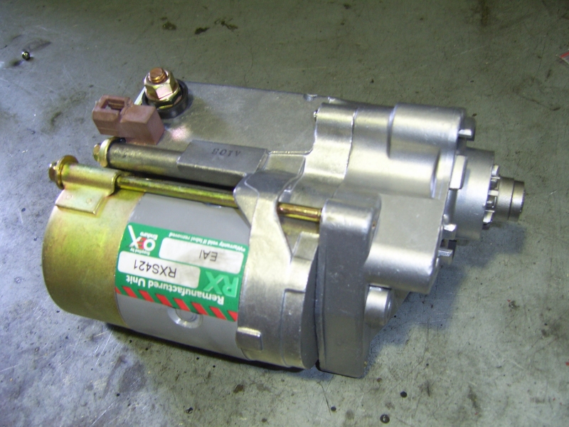

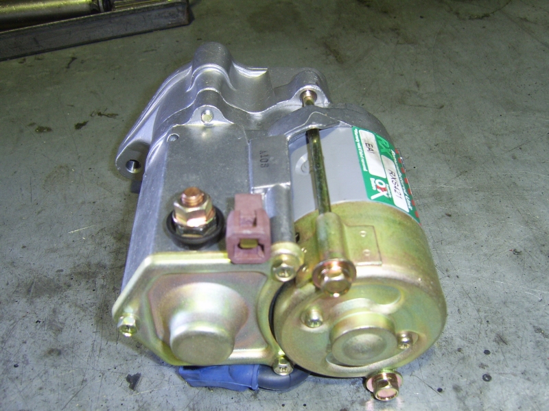

The other half of todays story, At lunch I decided to order myself a new starter motor as the one on the car has been roughly slapped together and doesn't always sound the best when starting up. Ordered a new one though Ashdown Ingrams and should be there tomorrow morning for me to pick up. Anyway, Got out to the car this afternoon and my starter has given up the ghost. (Mabey its jealous I have a new reduction starter coming to replace it?) Have to pimp it in the work race laser till tomorrow..
Got my reduction starter from Ashdown Ingrams yesterday ( RXS421 ) and fitted it to my car. So easy to start now and sound so much quieter!

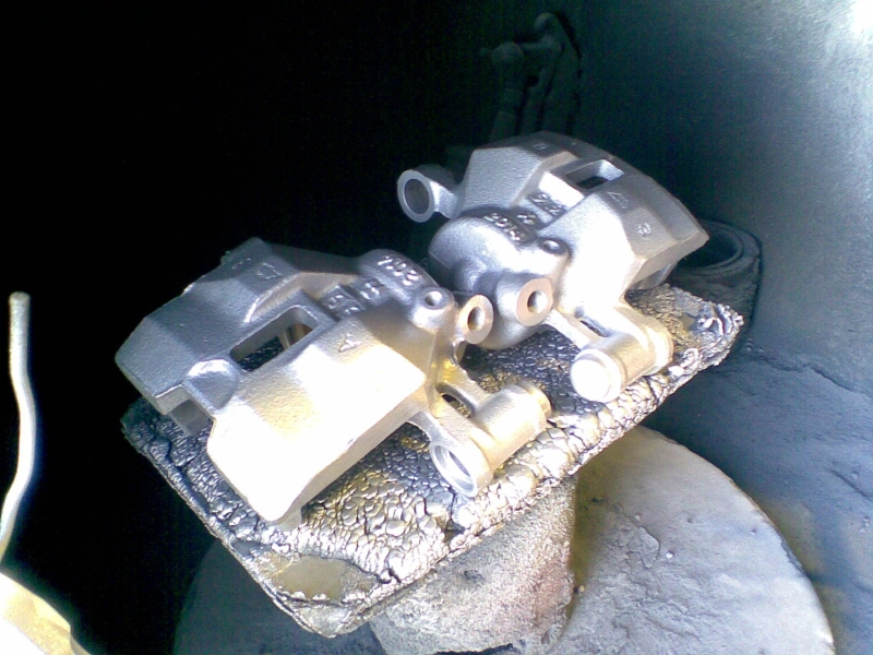

some progress shots of my calipers..
