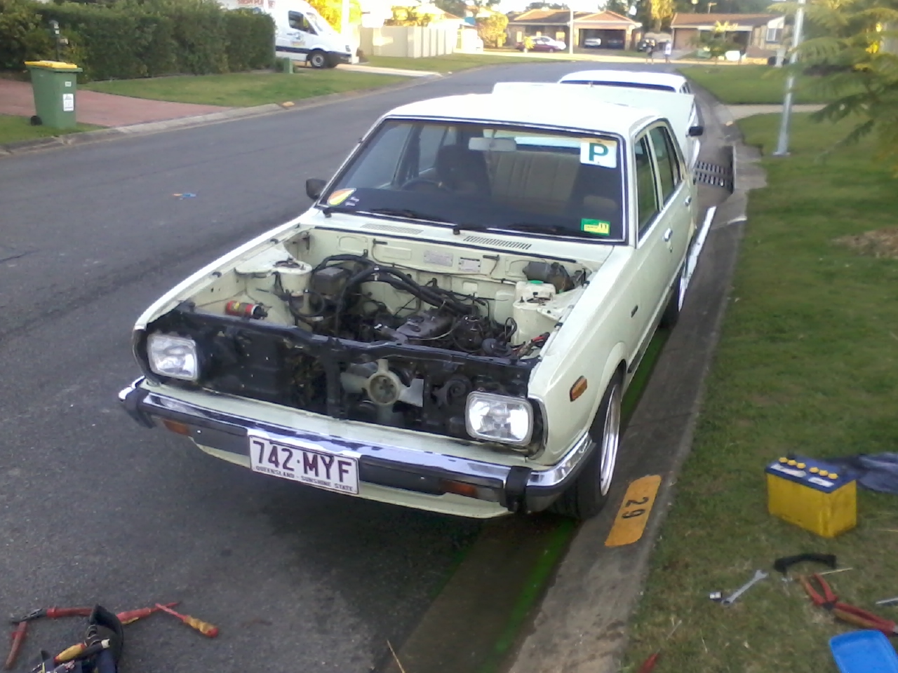

  20. MFW! the rolla is back. :dance: after many problems i have a 4k in and running. The reason why the 5k blew up was because the fuel pump. The rear seal had gone and it was not pumping fuel through to the carby, instead it was pumped straight into the block from the rear of the pump. causing the engine to fill with fuel and end up exploding oil all through the bay. :bash:
  21. Hey guys, been chasing a 7k at the local wreckers can't source anything worth while. So if you know of one for sale right now, or in a wrecking yard tweed to Brisbane swing me a pm or message on 0413195668. cash hand ready to go. Cheers Hayden
  22. Turns out the 4th cylinder was rooted, either piston or ring. it had no compression and misfired, filled with fuel and oil then shot up through the rocket cover breather on to the bonnet spraying into the fan then everywhere. Going to my local wreckers tomorrow to source a 5k or 7k, depending on price. Hopefully have one in by Wednesday This arvo's work consisted of disconnecting the engine, ready to be lifted out tomorrow.
  23. It does just, runs rough like it's dropped a cylinder, fair amount of blue-ish smoke on start up. it will not idle and revs are not consistent. I'll will clean it up and give it a go finding the leaks after i chill out :bash:
  24. I'm unsure where any of it has come from, as i just got the shits and parked the car. From what i can see there was some a spray point from the front of the engine that hit the fan and went everywhere. there is also a major leak somewhere nere the carby that shot straight up and covered the inside of the bonnet. Yesterday i got it towed home due to "bad fuel" diagnosed by the RACQ dude, clearly i have many more issues than that. Not sure if it's a replace the engine job or just a bolt on fix. I'll keep the updates rolling once i get the problem sused out
