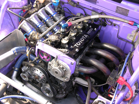

  7. P.S Thanks for the help guys. Just to let ya know my intentions for the engine. Max power and speed! You see, my good friend George has a 13b mild port with 48 weber in his Capella. He thinks “If it aint a rota it aint a motor”. Another mate has an EG Civic type R. He say’s “I change gears at 9 grand”, “V-tec this and V-tec that”. I just feel the 4age is the mighty engine everyone forgot about and want to give them a run for their money. Can’t go turbo coz this is an NA battle. Wanna do some drifting too. I’ll make a project thread soon.
  8. Hmmm didn’t think of that Philbey. Thanks. 16v heads have 2 X 3cm inlet valves. Total area of 14cm squared. 20v heads have 3 X 2.6cm inlet valves. Total area of 16cm squared. 20v must make power higher in the rev range than 16v? Yes I think to 42mm ST throttles will do nicely. Think I’ll go Small Port though. Not seeing any benefit of the Big Port when the throttle area is smaller than the port area. You see I need to decide which head coz they both need a recon.

  10. Thanks Kiahn Wanted to use my Big Port head and go all out. Already got some silver top throttles. As you say might be too small. The biggest issue I thought was that the port area on the Big Port was actually bigger than the area of the 42mm throttle. So like might be choking flow. Anyway might just use ‘em on my Small Port head. Wishing I had waited for some BT’s now.
  11. Hi. I have a 4age 16v big port head I was considering putting Silver Top ITB’s on. Although after measuring the area of the inlet port v’s the throttle area it seems that the 42mm throttle area is smaller than the big port inlet port area. I’m just wandering if this would choke the head of its flow capabilities. Now I’m no mathematician so my calculations could be wrong. But this is to the best of my knowledge. Port area: Area of Big Port inlet ports = 14.93cm squared Area of Small Port inlet ports = 10.68cm squared Throttle area: Area of Silver Top throttle = 13.85cm squared Area of Black Top throttle = 15.90cm squared I measured the diameter of the ports with veneer calipers about 1cm inside them. I’m thinking ST throttles would suit Small Port heads and BT throttles (45mm) would suit Big Port heads.
