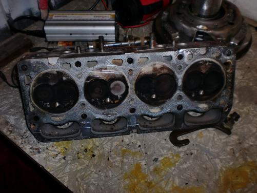

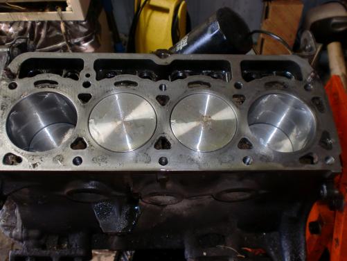

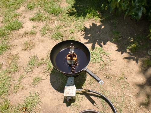

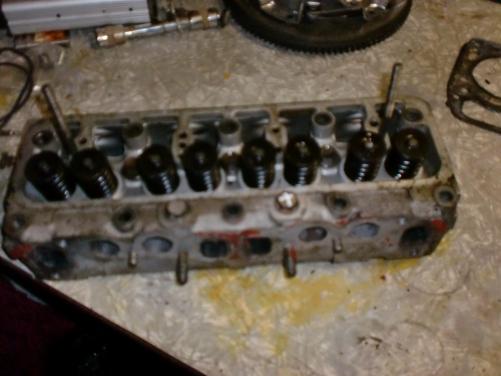

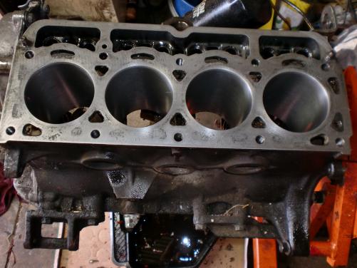

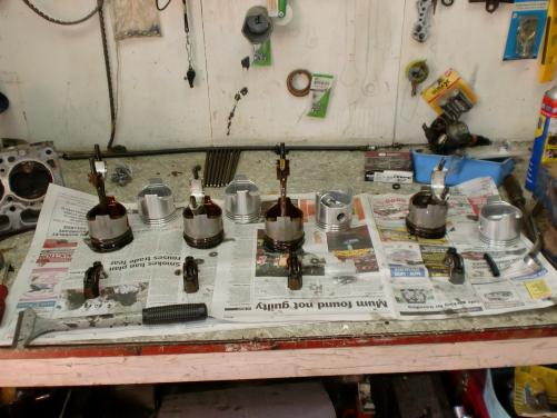

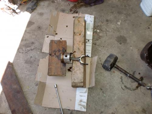

So I've been taking advantage of the week off, by playing engines. The 4k I put in in july doesn't have a heap of puff. Also has a lovely timing chain rattle on start up when hot. A few months ago I got a set of STD pistons and rings cheap off e-gay. A few weeks ago I picked up a 4k to use as a base. Plan is to keep it standard. Today I heated up the old pistons in sump oil, (using a wok burner) pushed out the gudgeon pins, honed, cleaned, refitted and replaced. On the head, I'm going to put in some new valve stem oil seals, lap the valves and get it skimmed. Then reassemble and should have a nice, tight, slow and reliable POS.
A regular 4k. Sam, I've seen your work and I'm impressed. Sorry about the blur in the second pic. Bamboo
