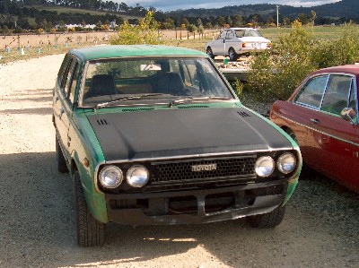

  2. this is how my ke38 looks with the corona twinnies, i probaly should have made up proper brackets for them but i couldnt be bothered so i just cabletided one side in and just put one light plug on, i had both of the wired up but they started f*cking up so i just have the outside ones now

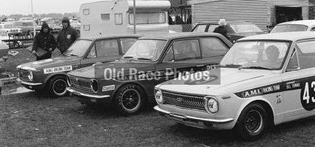

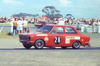

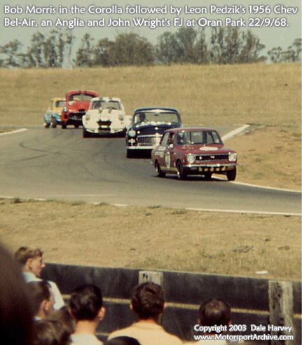

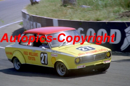

  19. i will post a few i have got from old race photos ^^^^^^this one is my favourite, its at baskerville in the 60's or 70's, i would like to get some pics and specs of these cars, they are great little things i have some more but i can't be bothered posting them at the moment cheers james
  20. yeah i have that mag to, and i got a few of the ke15, ke10's and ke11's at bathurst from old race photos but i have been looking for some more, also got a few of the team AMI corollas at symmons and baskerville and i was looking for more of the AMI racing corollas will post some in your new thread cheers james
