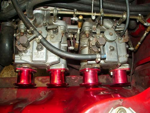

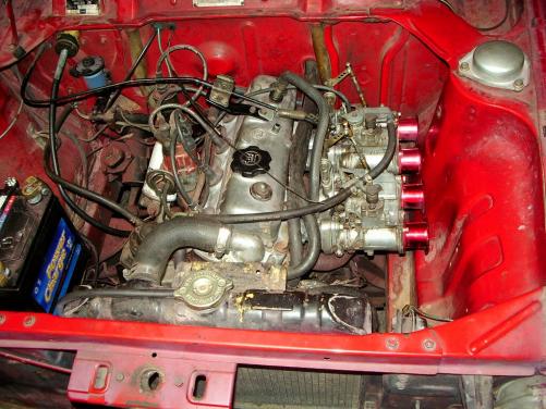

  22. Gday Cameron, Man the manifolds and carbs you have look awesome. I don't know much about these carbs to be honest, i got this 5K running and it has a stupid cam in it, (3000-7500rpm) had to take a mil off the head surface so the hydraulic lifters were still useable. i put a standard 4K carb on it and it went awesome then the solex carbs came up for sale complete so i have just bolted them on. No idea on what jets or anything, havent even tuned them but this thing revs and pulls hard and the induction noise is phenomenal. Good luck with your set up Cheers Justin
  23. Quick pic of solex carbs hope this helps
  24. Hey Cameron, i just fitted a pair of these solex carbs to my Ke10 this past week. its on a 5k also. i have used a Redline manifold which is approx. 72mm from the head to the carb mounting face. I have then got a ram tube on the end of the carbs which measure about 43mm and i am left with 2mm of clearance to the inner strut tower on the third from front intake tube. these measurements are taken on the car so not exact, but close Its a tight fit, i will try to get a photo up a little later Cheers Justin
