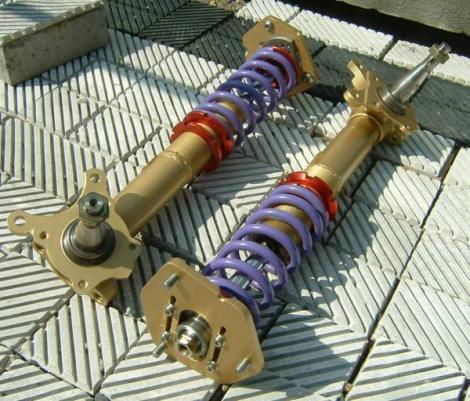

  6. Its no race car so if it steers straight and I am getting corona lcas and camber tops so that should defiantly fix the camber.
  7. Also have corona lower control arms to go in.
  8. Hi, I bought some ma61 coilovers with brakes for my T18 and now I heard that they screw up your caster and give you either positive or negative camber? Tryed looking on the net and looked through a dozen threads on here and couldn't find anything. The picture is of the coilover I bought. Also have custom steering arms of ae86 PS length with the correct bolt spacing and rcas to suit as well.
