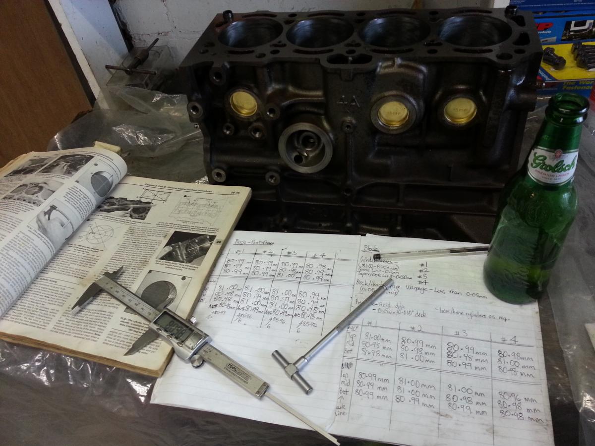

Blue Thing: The Daily / Motorkhana Hack (Now Efi)
carbonboy replied to carbonboy's topic in Rollaclub Rides
Haven't gotten as far as I'd like to have, but all is good so far. Pistons have rings on them & side clearances are perfect. This obviously came after checking the end gaps. Mains in, ready to check oil clearances.- 539 replies

New core plugs in, happy-hammer-fun-times. Good news, all I need is a set of standard-size piston rings, no special-sized jobbies. Win! The gap measurements are from the existing rings, so allowing for any wear a fresh set should see me by. Suppressing the urge to "bugger the measurements & just slap it together" is harder than I expected, but f*ck it, I only want to have to do this once.- 539 replies
